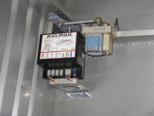

Brief Description:  Elevator bell crank and pitch servo
The pitch servo ended up directly in line with the bell crank. It needs to go on the left or right. Some suggested I put a spacer on the crank arm and extend it out to the right side of the bell crank. I decided it would be better to move the servo back with spacers and connect to the right side of the bell crank.
Not sure how to allign the servo
I think I'll space it back

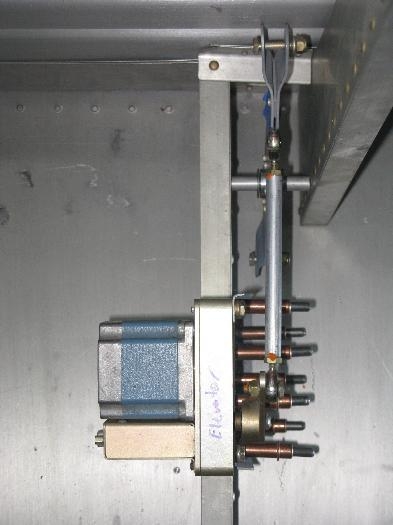

Another angle
Another angle
