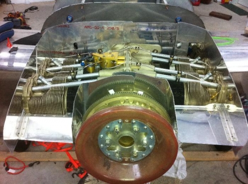

Brief Description:  Re-baffling the engine
I am adding a plenum cover so I need to remove the top of the old baffles. The parts with the rubber seal attached. Here are a couple of before and after pictures. It doesn’t look like much but I think it will be more efficient and look cleaner.
Also, the engine air intake is being moved to ram air below the crank, so I have to remove the filter located on the right side of the crank.
