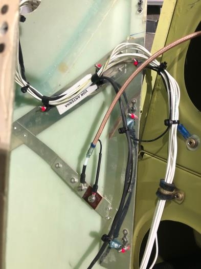

Lots of prep to getr ready for engine start..
redid the wiring for the ziptips and refixed the wingtiip

Ziptips wiring re-done
