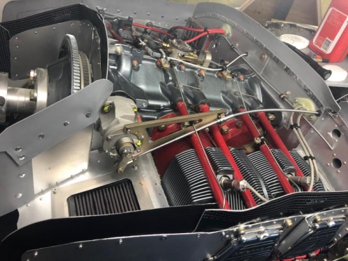

Finished off the baffle seals ans all look good. Hopefully it will be easier to get the front halves of the cowling together with less friction between the seal and the cowling.

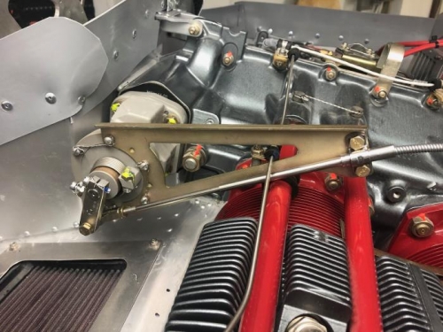

Fitted the Prop governor to its mount... nuts are bloody difficult to access as there isnbt enough room to get a socket onto them! Why the hell are they designed to be so difficult to fit!
Eventually managed to get them all fastened tightly. Had to move the fuel line to cylider 2 in order to get the cable mounbt bracket attached. Mounted the bracket, safety wired the screws, and repositioned the fuel line. Installed the Bowden cable.
Prop Governor installed
Teflon coated baffle seals installed
