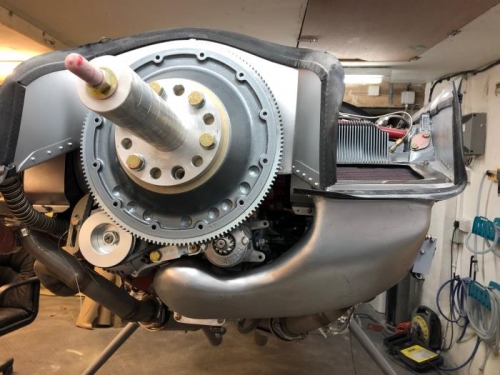

Brief Description:  fiinlly fitted the oil shutter and FAB
Just when I thought it was going well, I realised Id fitted the oil shutter upside down! Doh.. Turned it over then spent 2 hours fitting one nut in the most inaccessible place...

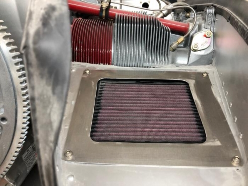

Fitted the automatic Alt air door, all the nuts are high temp lock nuts, with added 'permanant' loctite. Ive reversed the bolts, so that the nuts and washers are outside, so I can see them.
Fitted the FAB to the baffles, with AN8 screws through nutplates fibreglassed to the FAB so they cant break/fall off or shed rivets. The screws have a second lock nut outside so they cant migrate inwards
FAB fitted
FAB fitted
