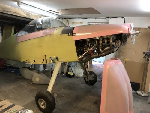

Date:  5-18-2019
Number of Hours:  6.00
Brief Description:  ECT/CHT wiring, tidying up other wiring
finished connection EGT/CHT wires and worked out neatest routing to keep all away from the exhausts. painted the mixture/throttle mounts. Fitted spinner /cowling mount and checked teh dimensions of the spinner and prop ordered from MT. I need a hub length (flywheel to center of prop blades/hub of198mm and a flywheel to rear of spinner distance of 105mm to make it all work. This leaves a 2cm overlap for final trimming at the rear later
