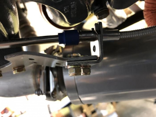

Made a bracket for the throttle cable and works well.

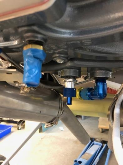

Fitted Sniffle valve and Quick change oil drain.
Changed the oil filter to a smaller diameter one to stop the obvious impingement present between oil return line and the filter

Throttle bracket
Throttle bracket
Sniffle valve and oil quick drain
