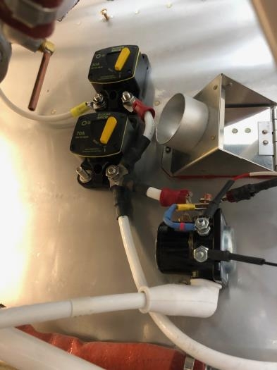

Brief Description:  Wiring the starter and alternators
Decided to have a 'clean day' after tidying up the dust from the previous few days. Spent an hour or so contemplating how to imlement the main power wires to the starter and two alternators. Couldnt find the plug connections to the alternators.
Ive decied to have weatherproof re-settable ANP circuit breakers on the firewall, a 70 amd and 30 amp for the alternators, with the ammeter shunt on the 70 amp one. Rather than hang 6 tabs on the starter contactor I decided to spread the load across the 'load terminal of the 70 ANP breaker and the starter contactor battery terminal.
Searched again for the alternator leads, and managed to find them!
Alternator ANP Circuit breakers
