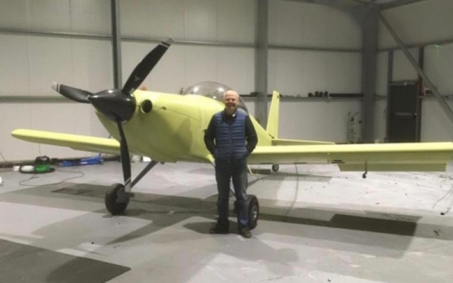

Chris helped me get to SB wing on. All bolts inserted, and torqued. Didnt notice that the secon washer on the upper AN4 bolt was missing, so ended up stripping the thread as the nut went over the end of the thread. Couldnt turn the nut to move in or out... ordred a nut splitter so that I can get it removed. Bugger....
Put the propellor on, then the spinner for a trial fit. Most nerve racking bit was then fitting the cowling to check that it fitted... fortunately it did so perfectly. Huge relief. Took a few pictures as it almost looks finished!
Looks like an aeroplane!
