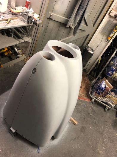

Cowling prep
First flash coat of acid etch primer... as usual, the 'perfect finish' disappeared, and was replaced by a myriad of pin holes!. Filled, and waiting to sand down tomorrow ready for another flash coat, probably of high build primer.
