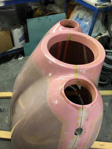

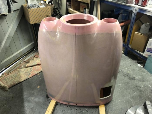

Cowling prep... epoxy coating
Fixed the lower cowl Skybolts. Sanded the cowling, then worked on the inlet holes and teh floating nutplates. Then 2 coats of slghtly tinned West epoxy, second coat applied 2 hours after the first. More sanding tomorrow, and hopefully no pinholes.
Epoxy coating the cowling
