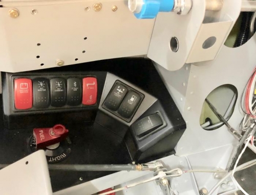

Brief Description:  Throttle quadrant and switch box fitting
Lined up the new switch box... Chris forgot the fuselage sloping sides, so had to trimm the back out of the box. Made the holes to accomodate the switches, and installed the switch box and the throttle quadrant, with the new cover plates. Not finally fixed, but I needed a picture to send to the Carbon dipper chap.
Fitted the SB CB panels, and discovere I had made holes that overlay the structiral part of the gear boxes, and I couldnt just drill the holes to match... so made another part, re-drilled the holes for the CBs in the right place, and refitted after priming. Just need to paint the carbon black and then its all ready to send off to the dipper on wednesday.
New switchbox
New switchbox
