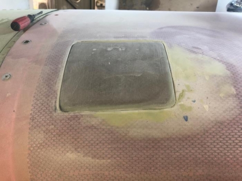

Oil door filling and sanding, looked beautiful... then I put the cowl on the plane, and then it didnt fit!
Minor bit of filling and sanding needed, but still took a couple of hours...

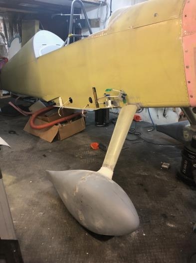

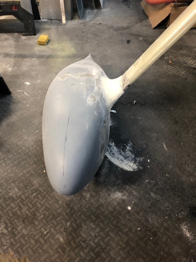

Started on the wheelpant intersection fairings. Used expandinf foam as a former, then sanded to shape. 3 layers of glass and epoxy, more sanding, then epoxy/microfibre filling. More sanding tomorrow...
