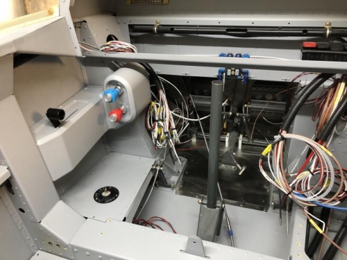

Cowling work and throttle quadrant
painted the throttle quadrant and installed it... needs some fettling as throttle friction too much.

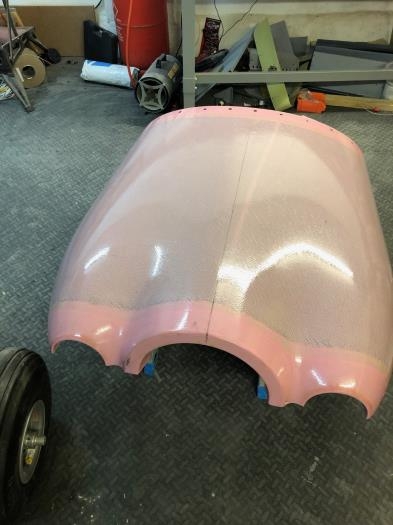

Installed nut plated at the front of the cowling, then added 3 coats of epoxy to the outer skin to seal it.
The honeycomb texture of the glass created a strange pattern on the epoxy... will just have to sand it down and then spray with high build primer
