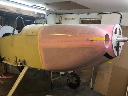

Sanded the flox filled line between upper and lower cowlings, then took all of, masjed the airframe, cowlings back on, and flox-faired the cowling to the airframe. Wiat for it to dry.... eventually got it all off again ready for sanding.

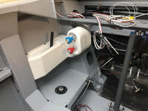

In the 'down time, I fettled the throttle quadrant, and put an acid etch and 2 coauts of high build filler. I see a lot of sanding coming in the next few days!
