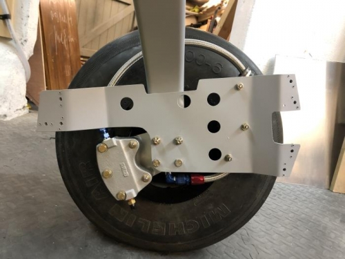

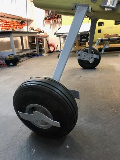

Finished off fitting the wheel fairings, added the nutplates to the brackets and painted them with acid etch primer and then 2k paint. Also painted the gear legs and put on blade tape.

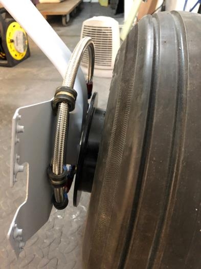

Redid the brake lines as the original ones were too tight. Managed to route them nicely and secured them to the brackets with adel clamps.
Started to install the leg fairings. A bot of work required to trim them to fit as they are from a Harmon Rocket.
Then the gas heater failed and it is too cold to carry on!
Modified RV10 fairing bracket
Brake lines run nicely
Original RV8 bracket used on the outer side
