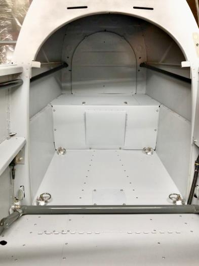

ELT wiring done. Had to solder the d-sub connector and wire in power and grounds. Used 3 strand shielded cable to run to the front.
Installed the rear parcel shelf/battery cover and the rear fuselage hatch.

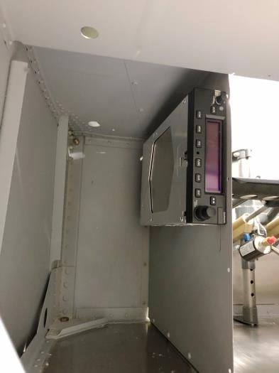

SPent some time pondering where to put the Comm2 radio and eventually decided to put it inside the deep section of the forward baggage compartment.
Had to juggle the angle mount bracket of the front shelf on the starboard side, but looks ok now.
Closed up the rear for a while!
Comm 2 installation
Comm 2 installation
