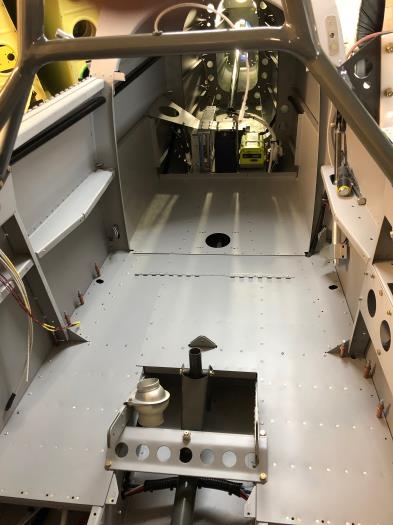

Swapped the port conduit out to larger stuff so plenty of room for aires in the future.
Rivetted the floor in, and finished the stiffeners.
Fitted the rear baggage floor with the new access hatch for the Transponder aerial.
Fitted the battery cover/baggage shelf and discovered that the battery is installed at 90 degrees to the floor, but the vertical element of the box slopes back by 2cm so it wouldnt fit!
Made a window in the vertical element, and then fabricated a new part to allow it all to fit. Needs a bit more tweaking to get it to look right, but its not far off.

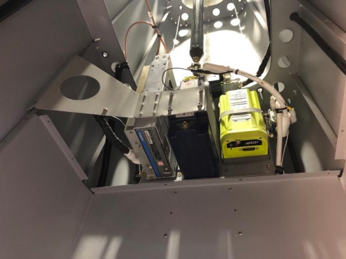

Brace to support the top ov the avionics
Floor installed!
Floor installed!
