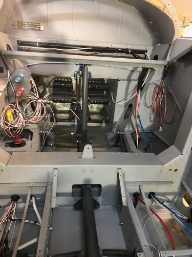

Ran the wires to the pitch servo from the front, and prepped ready for bigger conduit in a couple of days time.
Removed the Showplanes flap position sensors as these are not needed as the G3X will do all of the functions, and also will make wiring easier.

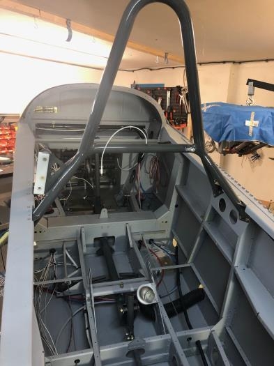

Fitted the roll bar back and rivetted it in position. Ran a lightning cable through the roll bar in readiness for the rear ipad mini mount. New ipad mini 5 released yesterday, so I bought two! Also bought a TSO'd mount for the ipad in the panel, complete with a second USB port and a built in fan. Purchased the switches.. laser etched, internal LEDS, so no need to worry about getting the panels etched.

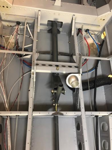

Finished rivetting the fireproof floor as more rivets arrived.
Sanded, primed and painted the cockpit side panels and looks neat.
Roll bar fitted and wired up for the ipad mini 5
Lots of wiring done!
Fresh air vent attached
