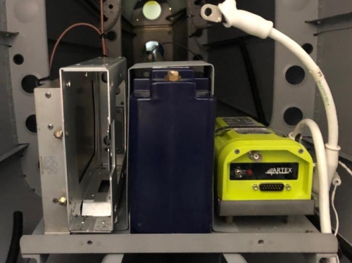

Fixed a bracket to the back of the avionics shelf, which improved rigidity significantly.
Fitted the DME abd the Garmin transponder. Re-routed the power and earth cables, installed the battery alarm lead, and the Co-ax cables to the DME and TPx antennae.
Fitted the 'Field of Tabs' to the firewall. Plan is to run the battery ground lead to this, and then run a spur to the starter motor, and one back to a FOD ground system on the cockpit side of the front baggage compartment.
Drilled a new hole in the firewall for the power supply to the cockpit.
