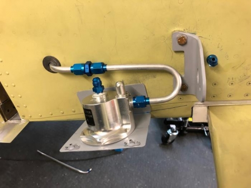

Brief Description:  Gascolator installation, nut plates installed for
Nut plates attached to the wing roots until I ran out of them! New order on the way from LAS.
Gascolator pipework installed and fuel selector fitted back. Made a bracket to hold the fuel pump, which will now go where the the original fuel filter went. Easier to get at for maintenance.
