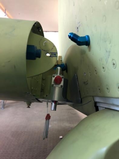

Aerolab Gascolators arrived today... works of art!
Mounted them to the bracket that I made, and drilled holes in the fuselage skin for rivets.
Checked in with the 'mothership' yesterday and confirmed that they are happy to attach the bracket with small rivets that will fail in tension should the wing get knoocked off, but still be strong enough to cope with the shear loads placed on it.
Plenty of room for the fuel lines, and it all looks good!

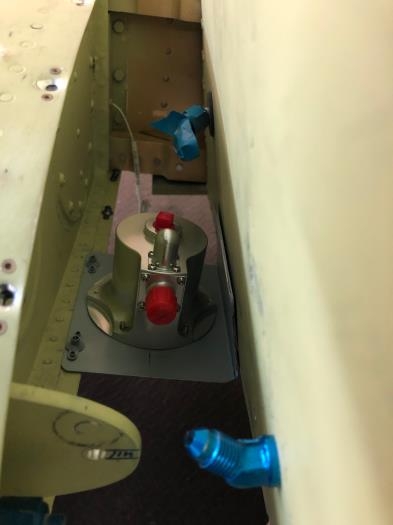

Aerolab gascolator in wing root

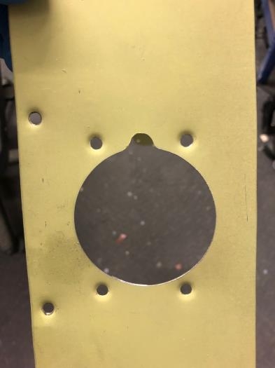

Fairing skin cut to shape
