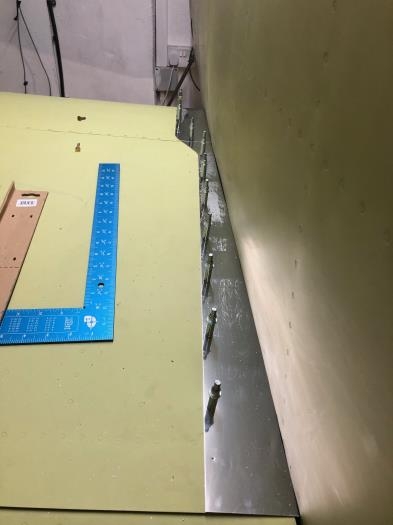

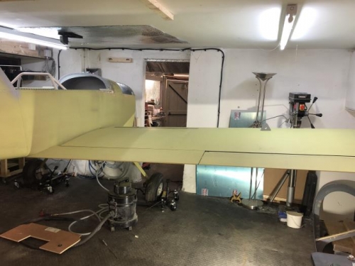

Fitted flaps, made pushrods and connected to flap motot. All work well, and fit really nicely. Trimmed and clecoed the wing root fairings. Started to work out how to install the flap fairings, and also made the step fit the fuselage. Will need to get it shortened by 4"
Flaps fitted, all lined up nicely!
Wing root fairings
Wing root fairings
