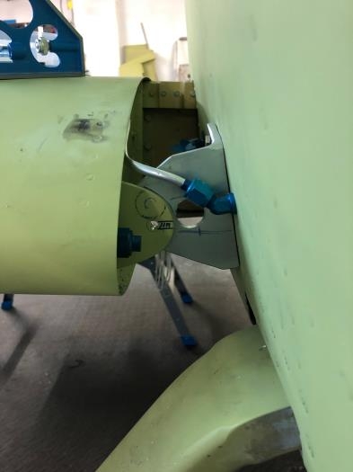

Brief Description:  Tank mounts fitted, aileron controls hooked up
Re-made the tank mounts again, all fit well now. Primed and ready to fix in position. Fuel vent lines attached, then aileron pushrods attached and stick held in neutral
Fitted 90 degree coax ends to cable for transponder and Marker beacon aerial.
Tank mount and vent lines
