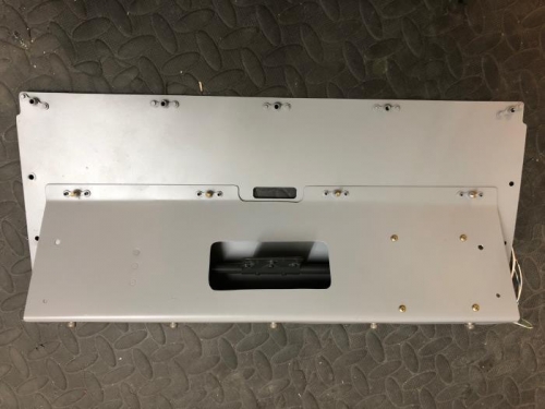

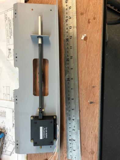

Spent most of the day working on my electric rudder trim mod, based on the spring-loaded aileron trim. Had to make a mount and a housing for the Ray Allen servo, and fabricate connecting cables using 2.5mm rigging parts. Had to guess the spring size, and need to get some a bit longer.
Will need to submit a mod application to LAA but I'll wait to see if it works first.

Housing for electric rudder trim
