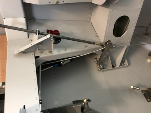

Brief Description:  Rear rudder pedals
Picked up a modified rear rudder pedal connecting rod... extended by 25mm and with a second set of holes. All standard fittings connect to the lower hole as per Van's original. the upper holes will accomodate the bolt that holds the centralising springs and cables connecting to the rudder trim.
New connecting strut to accomodate rudder trim cable
