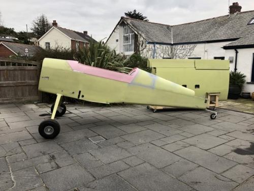

Brief Description:  Wheels fitted... mobile at last!
Took the tail off the stand and installed the tailspring and tailwheel. Then tackled the installation of the bigger wheels and Grove brake kit. The brake lines that I fabricated are a snug fit, and I think they ought to be about an inch longer now that the wheel pant mounting plates are on.
Wheeled the fuselage outside, and spent a couple of hours rearranging the workshop in prepartion for putting the wings on.
If I take the tail spring off, there should be enough room to mount the empennage and the wings to get it all squared up before pulling the wings off when the engine arrives.
standing on her own at last!
