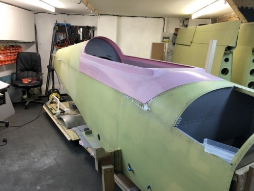

Trimmed part of the Fastback canopy, rivetted the cockpit rails and realsied I need to install the mid cockpit roll bar in order to fit some of the fibreglass bulkheads. Welding the new roll bar will have to wait...
Fastback canopy trimmed
