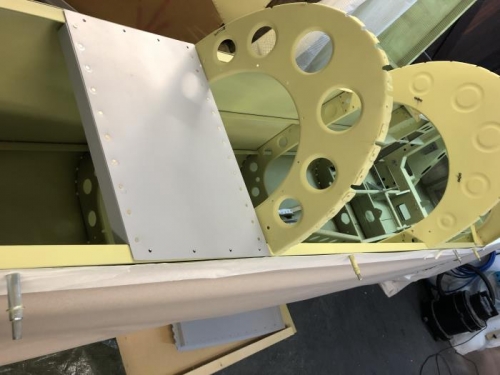

Rivetterd the rear avionics shels and attached to fuselage. Solid structure to mount ELT, MFD RSM and Garmin RSM.
Removed for priming, and painting tomorrow.
