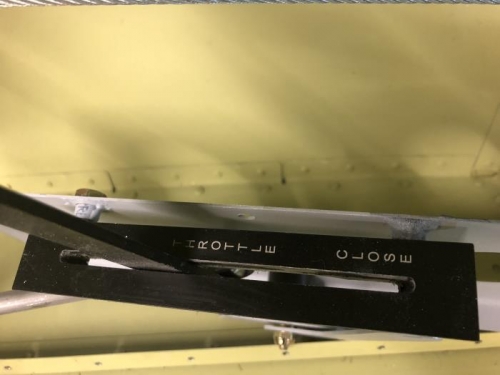

Brief Description:  Rear throttle quadrant work again
Fabricated connecting rod between front and rear quadrants, and fitted the rear throttle to the arm rest. Makes a horrible scratchy noise as the arm passes through the face plate. Sounds cheap and nasty, so off it came again!
I used the polyethylened strip supplied by Van's for their rear throttle. Cut lengthewise, then drilled into blind holes in the rear of the faceplate. Tapped he faceplate and mounted the polyethylene, using high strength Loctite to secure the machine screws. Much smoother!
