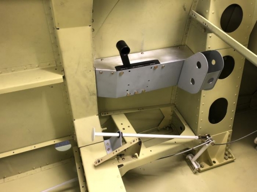

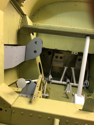

Brief Description:  Throttle quadrant done!
New throttle arrived... basically I ordered two RV8 Rear throttle levers so taht they match. Had to redesign (again!) the quadrant housing. Built the mixture/prop mount, swapped 8 an470 rivets for an426 rivets on the gear tower so that it all fits flush. Really stable, and very please dwith the functionality.
Throttle cable attached, and it al works smoothly.
Started on the rear throttle installation.
