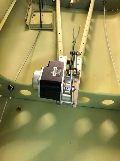

Next job was to rivet the Garmin pitch servo mount in place, after confirming with LAA that I should follow the manufacturer's instructions, and there are no additional requirements.
Baggage door lok fitted
Pitch servo rivetted in place
