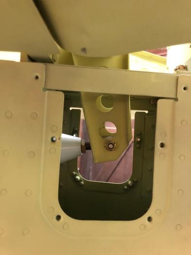

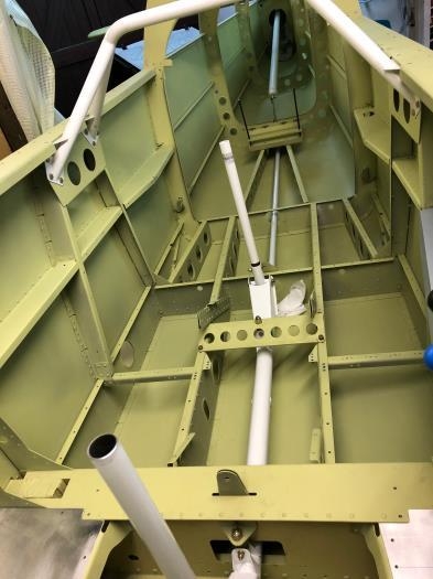

Brief Description:  fitted control rods, adjusted the lengths and trie
All control rods fitted, and elevator horns drilled after clamping to HS to get them level. Needed to remove a lot of the 'stop' panel to get the required amount of upwards movement. Checked with Van's about how much I could remove, and apparently I can take even more!
Eventually got the required deflection range.
elevator rod attached to horn
