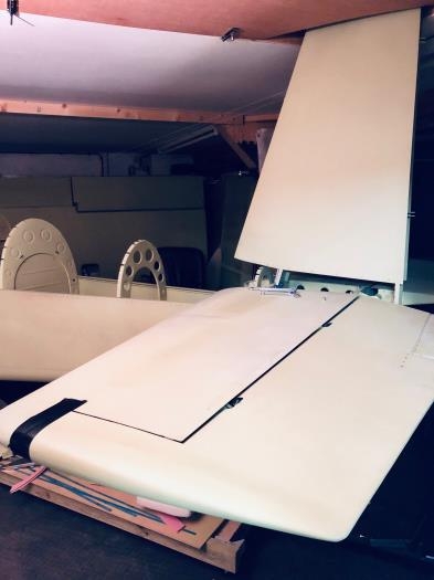

Brief Description:  drilled and fitted H and VS, fitted elevators
Final adjustment to the position of the HS and VS, all aligned within 1mm of 'true'
Bolt holes drilled and new bolts attached. elevators fitted temporarily, elevator horns match drilled.
