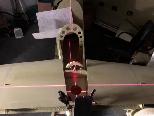

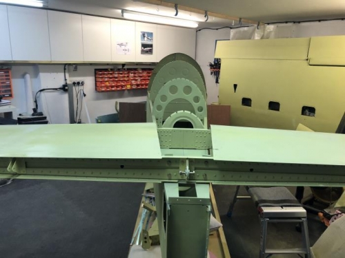

Fuselage levelled in bot planes, to within 0.1 degrees, and then the HS attached. Mounted a laser cross beam on the ceiling, and it made setting up easy.
HS symmetrical on plan view to within 1mm and les than 0.1 degree incination and lateral tilt. Very happy!

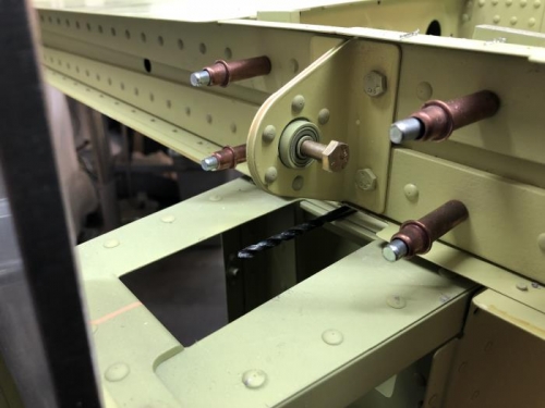

Drilling the rear bolts was easy, but getting the front bolts installed, getting edge distances right, and trying to drill perfect holes was a challenge.
All lined up well, and feels absolutely solid. Will need some deburring and prep of the hole edges on the spar to ensure that there are no stress raisers, but overall all went well. Beter than the undercarriage attachment...
laser cross hairs make alignmment easy
