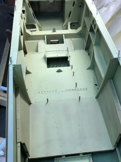

Odd day...needed to remove the throttle quadrant pre-fitted during QB so that I caould drill holes for the lower panels... stripped the head on a screw and took two hours to drill/grind the nut plate off an reinstall it... immensely frustrating!
Fitted the front seat base, the seat backs, refitted the mid fuselage brace weldment and installed the battery box.
The Andair fuel selector is ordered, and the Flyboys throttle quadrant is awaiting customs clearance but should be here on wednesday.
Im planning to modify the throttle quadrant/arm rest so now working on the design.
Fitted the braces for the panel mount.
