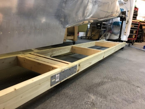

The engine stands are great, allowing free rotation of the fuselage, but impossible to move the whole assembly!
The fixed wheels on each stand mean that turning them is impossible, ant they tend to tip.
Back to B and Q for more timber, and new free rotating castors.
Extensive modification of the wheels to get everything lined up and level, then constructed a timber frame between the engine stands, attaching them with metal joist hangers bolt through the engine stand frames. Now have a mobile fuselage stand assembly that can easily be moved around the workshop and outside.
Rotisserie plateform construction
