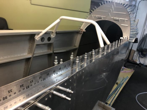

Showplanes kit part two.. old canopy side rails needed to be removed, then replaced with ones that fit the FBcanopy as its a different shape at the front.
No problems drilling out the rivet heads, then pushing the rivet shank through without enlarging the holes.
New rails edged, deburred and match drilled in place, then dimpled ready for priming
