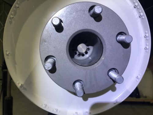

Lots of jobs done today... Fuel lines tweaked and torqued up, gascolators installed finally, fuel selector reinstalled, and 20l fuel put into each tank. No leaks so far!
Fuel tank sensor wired up each side.
OAT probe connected ( linked into the 9 pin d-sub with the pitch trim servo)
propellor wasnt sitting right, so I took it of and eventually figure out the indexing pins... took a while to realise that the porp can by 'Mercedes' or 'Y' orintation, hence two sets of indexing pins. prop bolts tightenred, and ready for safety wiring.
