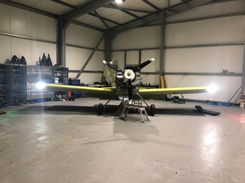

Date:  2-23-2020
Number of Hours:  5.00
Brief Description:  ziptips connected, wiring loom tidied inside
Spinner attached and torqued up
ziptips on port side removed, cables re-routed to avoid crossing the nav aerial. reattached, and both connected.
All lights work except the wig wag. Wiring diagram checked.. should be switched to ground via a 1amp CB, not to power!. I will swap it around tomorrow
Second com aerial attached, and the cables around the aileron push rods zipped out of the way to prevent contact between the push rods and the wires.
Tyres inflated to correct pressure which helped level up the wings!
the ZipTips arre really bright!
Bright lights!
Bright lights!
