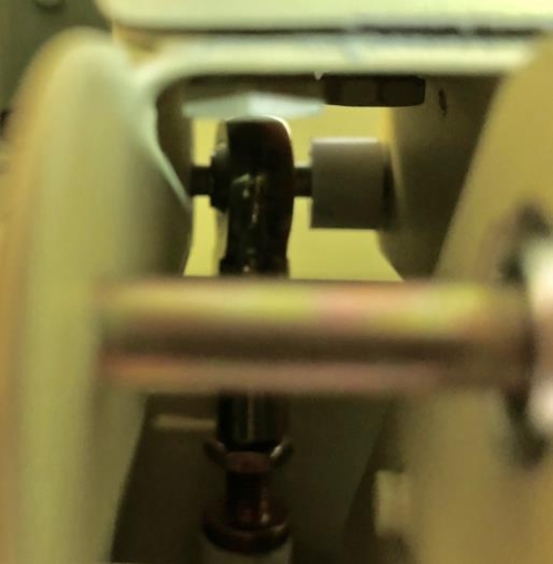

Tried various diameter Delrin rod spacers.. the 12mm rod gave 31 degrees of upward travel, well within limits. Autopilot roll servo limiter just beyond the range of movement permitted by the delrin spacer, so all looking good.

Delrin spacer
Delrin spacer
