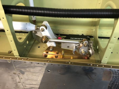

Brief Description:  Garmin roll servo fitted
The Garmin roll servo arrived, so it was time to fit it to the starboard wing. Not difficult to do, but had to remove the aileron bellcrank fittings, replace one of the fixing plates, and rebuild the bellcrank after attaching the roll servo. The bellcrank has a pre-drilled hole for positioning the servo pushrod, so hopefully all will work when powered up.
Also ran a couple of extra conduits through the wing, so there will be three in each. Advised to keep high load wires away from the others, especially coms cables.
i guess it's fitting the wingtips next.... They wil be mounted using nut plates and screws so that I can remove them in the future if needed.
Garmin Roll servo installed
