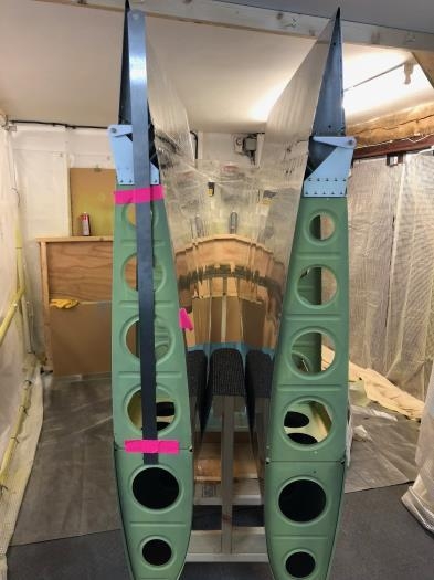

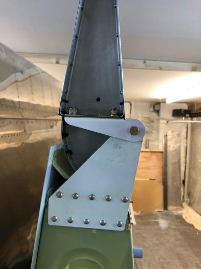

Ailerons hinges fitted and ailerons attached to wing. Aileron pushrods fitted and centred to ensure that the tooling holes for the wing and aileron align.

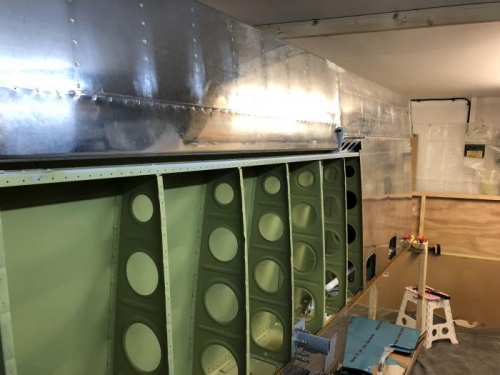

Left flap hinge attached to ensure minimum edge distance. Still 1/32 short of the aileron at TE, but cant figure out how to change it... If anyone gets a straight edge and checks, they'll spot it. If the flap fell off due to inadequate edge distance, I'm sure I'd notice!
Aileron and wing tooling holes aligned
Aileron hinge
Aileron hinge
Flap and aileron fitted to left wing
