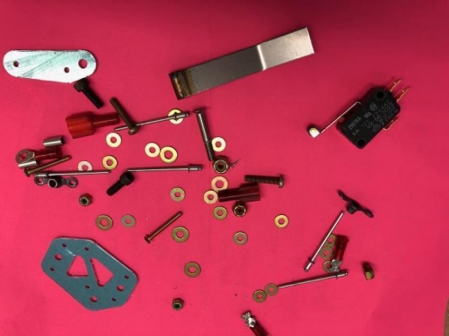

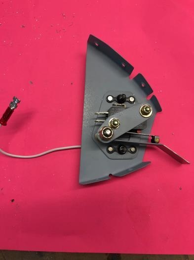

I then realised that the stall warner needed to be assembled from dozens of individual components! Very satisfiying when it all worked at the end.

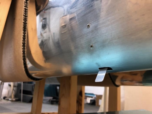

Stall warner and bracket fixed to wing.

all assembled!
all assembled!
And installed!
And installed!
