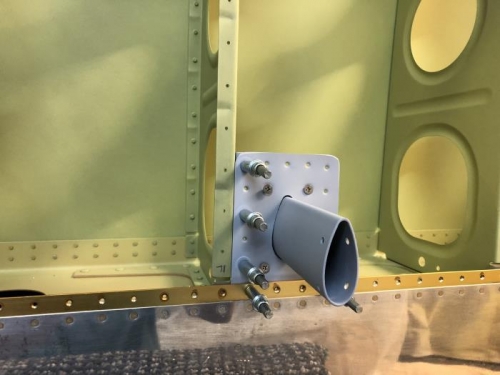

Brief Description:  Gretz pitot mast installed
Gretz mast fitted. Needed to match the base plate and plate washer profile to the mast as they are all slightly different. Made angle bracket to attach the base plate to the rib, and match drilled everything.
Temporarily attached lower outer skin so that I could mark the location of the mast as it penetrates the skin, then cut out the shape using the Dremell.
All fits beautifully!
