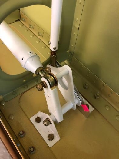

Brief Description:  Aileron pushrod installed, .
Aileron pushrod installed after inserting the rod-end bearings.
I made a second bellcrank jig identical to the supplied one, so that there is one for each side.
All mounted up, but not torqued yet. I'll do that once all of the pipes and cables are installed.
Aileron pushrods inserted
Port aileron bellcrank
SB aileron Bellcrank
