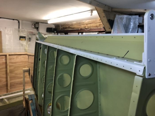

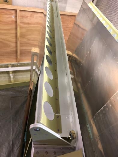

Brief Description:  flap and aileron braces fixed to spar
Aileron hinges rivetted and fixed to rear spar. Flap brace rivetted to rear spar with blind rivets. New electric blind rivetter works brilliantly!. No more arm ache!
Aileron flange rivetted to spar, and clecoed to front skin. No guidance on whether to rivet the skin and flange at this stage so more VAF searching... apparently its ok to rivet now.
Flap brace installed. Skin dimpled and brace  countersunk
Aileron brace rivetted to spar
