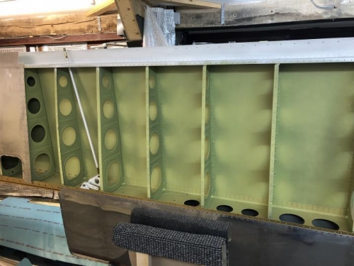

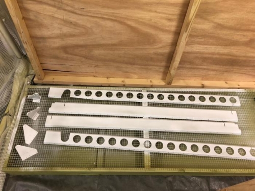

Internal wing spraying
Interior of wings prepped for painting. Etch primer then 2 pack epoxy on every internal surface that I could reach.
Aileron and flap braces prepped and painted with the same. Hinges fabricated and painted.
