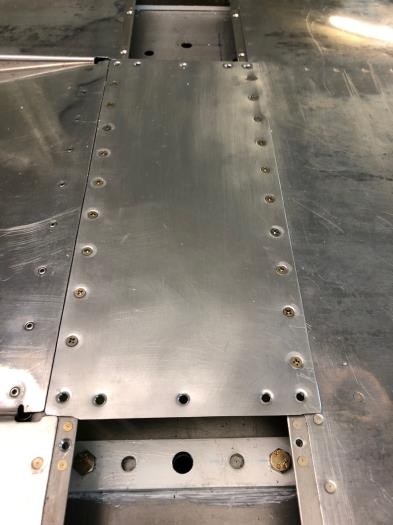

Brief Description:  Constructed the centre undercarriage cover plate
The single piece gear means that the central extension of the lower skin had to be removed. Originally rivetted in place, but seemd sensible to make a new one that used machine screws to fix it back on, so that the undercarriage can be removed if required. Lots of not plates, so yet another order from LAS!
