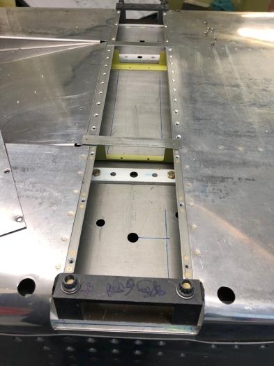

Intercostal ribs trimmed and re-installed. Centre plate fabricated and prepped to attch to the fuselage with machine screws so taht its all removable.

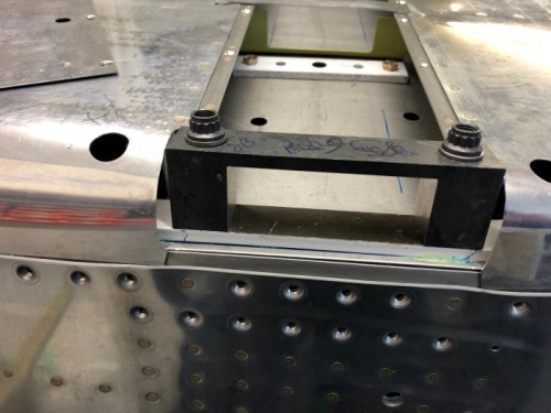

Ive reversed the bolts in the gear tower so that the nuts are external, thus aiding regular torque checking. Seems better than trying to torque nuts in a tight enclosed space internally.
12-point nuts fitted externally
